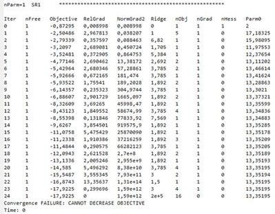

I am working on a project in JMP 16, where I use the “Minimize”-function. When running the function I often encounter the error “Convergence FAILURE: CANNOT DECREASE OBJECTIVE”. Looking at the final results of the script, they are as expected. It therefore seems that the error has little influence on the final results. However, to ensure the validity of the script, I would still like to know the reasoning behind the error. I have had difficulties finding any documentation about this specific error, and therefore hoped someone in the JMP community could help identify the cause.
Using the “<< Details( Both )” option for the minimize function, below image of the log was obtained:

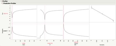

Looking at the Profiler for the function (see below, and the attached data table), it does look like Minimize() is giving a good answer.
Perhaps @chris_gotwalt1 can give an explanation of the error message you're receiving from the call to Minimize().

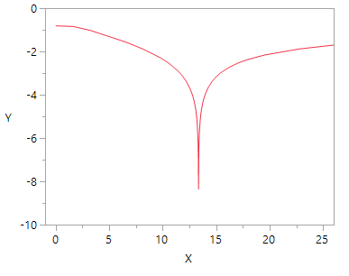

You could make a graph, like this:
expression=expr(Log10( (ChiSquare Quantile( alpha, df ) / df - Vratio) ^ 2 ));
alpha = 0.025;
Vratio =  0.39135;
df=2;
Minimize( expression, { df( 2, 1000 ) }, << Use Numeric Deriv( "true" ) );
show(df);
New Window( "Example",
	Graph Box(xscale(-1,26),yscale(-10,0),
		Pen Color( "red" );
		Y Function( expression, df );

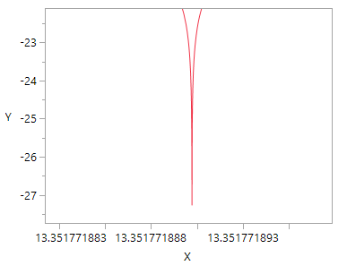

there is a sharp drop at the df found by the minimize function.there is a sharp drop at the df found by the minimize function.
you can zoom in on the sharp drop and see it is going to be computationally difficult to get a perfect answer:
9 significant digits, and more to go.9 significant digits, and more to go.
minimize found df = 13.3517718809044;
I'd guess that the minimize algorithm hits a point on the curve that finds the next point on the far side of the true minimum, and might even be in a cycle bouncing across the minimum. With a different starting value, it might get close enough to decide to stop. Close enough is also a parameter you can pass to minimize (tolerance).
