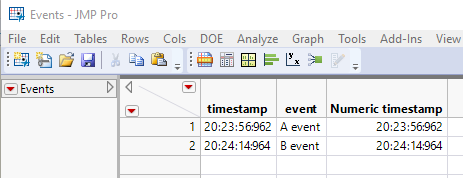

I don't know if this will be helpful, but here is a script that will take your timestamp values(I am assuming the timestamp column as you have it defined is a character column), and convert them into a numeric column.  The new column can then be compared with the time(s) column for putting together the data.
names default to here(1);
// Create the sample data table
dtEvent = New Table( "Events",
	Add Rows( 2 ),
	New Column( "timestamp",
		Character,
		"Nominal",
		Set Values( {"20:23:56:962", "20:24:14:964"} )
	New Column( "event",
		Character,
		"Nominal",
		Set Values( {"A event", "B event"} )
// put in a time delay so one can see the initial data table
wait(5);
// Create a numeric version of the timestamp data
dtEvent << New Column( "Numeric timestamp",
	Format(
		"Custom",
		Formula(
			Char( Hour( value ) ) || ":" || Char( Minute( value ) ) || ":" ||
			Char( Floor( Second( value ) ) ) || ":" || Word(
				2,
				Char( Round( Second( value ), 3 ) ),
		20
	formula(
		Num( Word( 1, :timestamp, ":" ) ) * 3600 + Num( Word( 2, :timestamp, ":" ) ) * 60
		+Num( Word( 3, :timestamp, ":" ) ) + Num( "." || Word( 4, :timestamp, ":" ) )
Jim
