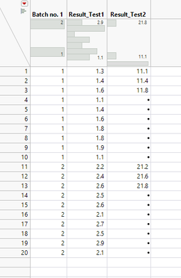

Hi all,

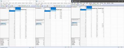

I need to add the data in the column "Result_test2" from the table "Untitled 23" to a new column in the table "Untitled 22". The data must be arranged as shown in the table "Untitled 27". For each batch in the first table ("Untitled 22") there are 10 data points per batch, but in the second table ("Untitled 23") there are only 3 data points per batch. I have tried various possibilities with the JOIN function, but it does not give me what I need.
Help is greatly appreciated
Best regards,
M

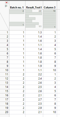

Add grouping row order column to both of tables:
Untitled 22:
Col Cumulative Sum(1, :Batch no. 1)
Untitled 23:
Col Cumulative Sum(1, :Batch no_2)

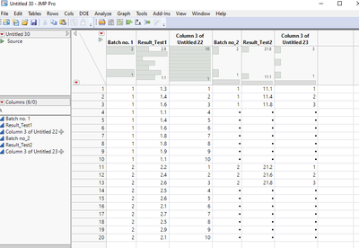

Join with something like this:
Remove extra columns:
-Jarmo
