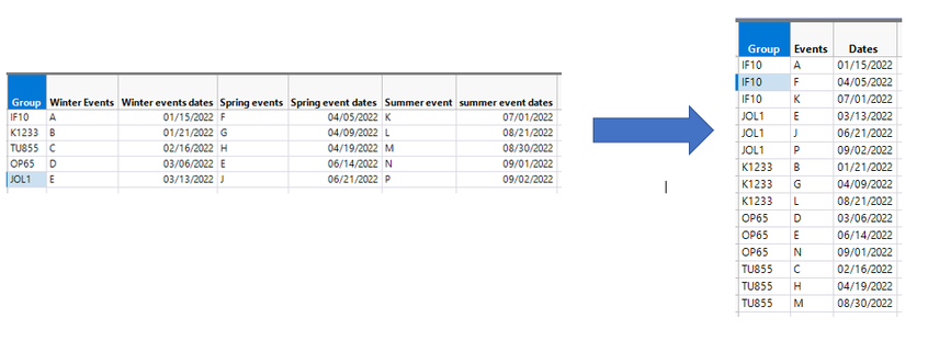

Hello,
What is the best way to merge 3 group of columns (Example below: 1 column "Group", 3 columns "events", 3 columns of respective dates) into 3 columns with the list of all events attributed to each group and corresponding dates? This is only an example, i am looking for a solution to address big number of rows. Thanks!

Use
     Tables=>Stack
and specify a Multiple Series Stack
Jim

Re: Merge columns with corresponding dates
I suspect that you mistakenly specified the "Number in the Series" incorrectly.  It should be specified as 2.  See below
Jim

Hello,
Thank you for your reply.
I tried the stack function with multiple series, it seems to not work as my columns are different data type:
Jim
Thank you! It works
