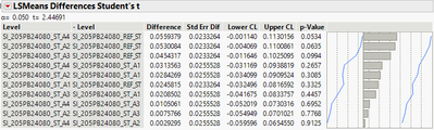

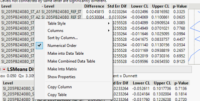

At the Fit Model output window we can take the mean differences of an effect. We can choose among various methods such as  Student and Dunnett.
The following is the output of the dunnett method
where the format of the diffs is : Batch - Control but the confidence limits are not the same as in the students case:
So what I would like is to take the second table. The results of the student's diffs but in the format of the first.
I want to include this part of the code in my script for my add-in. Is it possible to get something like this?

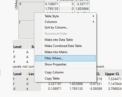

I'm not sure what you are trying to do, but maybe you want to filter out non-control levels? Table Boxes have Filter Where which you can use

I am trying to filter the table so that I have only comparison with the control and in the following format:
Level  - Control (I mean that the control should be in the second column)
What version are you using?
I am using 16.2 and I do not have this choice....
jthi
Re: Mean differences Student's t Table as Dunnett's differences table.
JMP18.1
