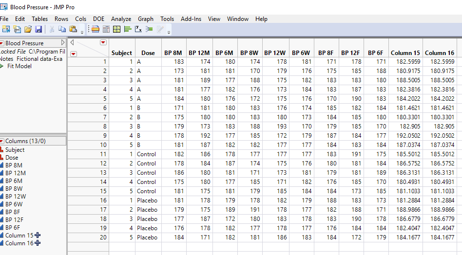

Here is my script, with the only change that it is pointing to the the SAMPLE data table "Blood Presure".
Names Default To Here( 1 );
dt = Open("$SAMPLE_DATA/Blood Pressure.jmp");
colList = dt << get column names;
colList = Remove( colList, 1, 2 );
Show( colList );
New Column( "Column 15",
	Numeric,
	Continuous,
	Format( "Best", 8 ),
	Formula(
		Max(
			As Column( colList[1] ),
			As Column( colList[2] ),
			As Column( colList[3] )
		Set Selected
Eval(
	Substitute(
			Expr(
				New Column( "Column 16",
					Numeric,
					Continuous,
					Formula(
						Max( __col1__, __col2__, __col3__ ),
						Set Selected
		Expr( __col1__ ), Parse( ":" || Char( colList[1] ) ),
		Expr( __col2__ ), Parse( ":" || Char( colList[2] ) ),
		Expr( __col3__ ), Parse( ":" || Char( colList[3] ) )

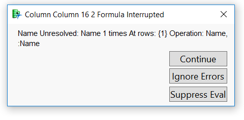

The issue may be that you have complex column names, that have characters in them that JMP is trying to do calculations on.  If that is the case, you need to change the Substitution to:
Expr( __col1__ ), Parse( ":Name\!"(" || Char( colList[1] ) || "\!")" )
Of course, change if for all 3 Substitutions
Jim
Botzal
Level III
Re: Maximum value of several variable columns to specific rows
Sorry, but it's still not working (solution 2).
My coulmns names - Date, format -01/30/2019 .
Thx.
txnelson
Does the sample code that I provided work, just as I have provided it?  It should work without change.
The error statement indicates that you are having a problem with the recognition of the word "Name" . Could you provide a sample of your data, and your script that is failing?
