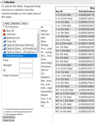

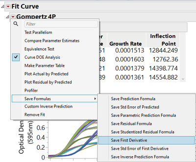

Hi @ddooley2 ,
You could try saving the first-derivative formula under the curve you have applied in Fit Curve
You can then take the saved column and use Tables > Summary or Tabulate and create a table with the max first derivative (slope) values.
Hope that helps,
Thanks,
Ben

Re: Max specific growth rate from OD data
Hi, Ben! Thanks for your quick reply. That's an interesting solution, but if I'm not mistaken, the first derivative reported is the instantaneous slope at each time point (or something that approximates to that). Unfortunately, that is a bit too localized for accurate max specific growth rate. Ideally, the slope would be calculated based on several time points (up to a few hours worth of time points) at which the growth rate is highest to prevent overestimation due to any small positive fluctuations in OD.
Yes, it is the instantaneous slope at a given X, but the estimate is based on the fitted curve, which used all the data.
