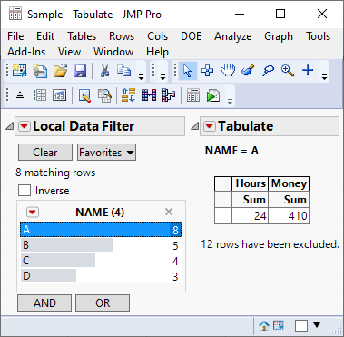

I'm not exactly sure what you want to calculate using the tabulate.Basically same thing you would get with Local Data Filter?

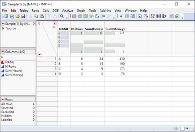

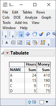

Is there some specific reason why you wouldn't perform all calculations either with Summarize or Tabulate (or maybe Summary table)? Below are examples:
Tabulate:

Summarize:
Names Default To Here(1);
Summarize(Current Data Table(), names = By(:NAME), sum_hours = Sum(:Hours), sum_money = Sum(:Money));
Show(names, sum_hours, sum_money);

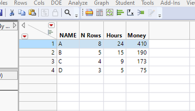

I think that all you need to do is to use the Summary Platform.
Names Default To Here( 1 );
dt = Current Data Table();
dt << Summary(
	Group( :NAME ),
	Sum( :Hours ),
	Sum( :Money ),
	Freq( "None" ),
	Weight( "None" ),
	statistics column name format( "column" ),
	Link to original data table( 0 )
Jim
Tabulate:

Summarize:
dt << Summary(
	Group( :NAME ),
	Sum( :Hours ),
	Sum( :Money ),
	Freq( "None" ),
	Weight( "None" ),
Jim
