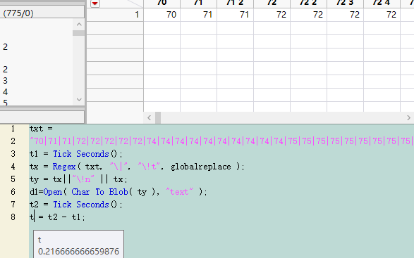

lala
Level IX
Re: Looking for tips for rapid conversion of string to matrix
0.217 ms

Level III
@lala , note you were using Tick Seconds() which gives you times in seconds, whereas I was using HPTime() / 1000 which gives me times in Milliseconds. Your example is actually 216 msec which is 2 orders of magnitude worse than my solution which does it in < 1 ms, which is still much too slow for me !
Letting d1 be a private data table in your example does halve the time down to ~ 100msec, but still... much too slow for what I needed to do
