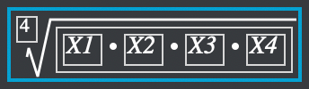

You can easily make a formula for the geometric mean. It is simply the Nth root of the product of N values. Here is a picture of the formula for the case of four variables (X1-X4):
Screen Shot 2019-08-30 at 9.49.09 AM.pngScreen Shot 2019-08-30 at 9.49.09 AM.png
