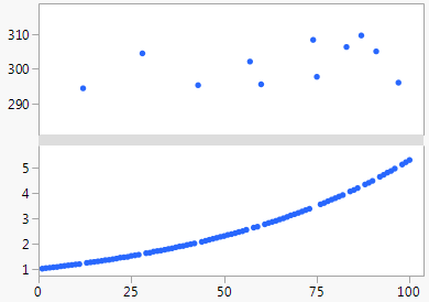

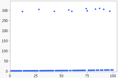

I occasionally get asked about making broken axes in Graph Builder. It's not something I like to do since it requires more conscious thinking to process, but I realize sometimes options are constrained. There's a way to get the effect in Graph Builder and I'm planning to write a blog post about it. Below is my contrived data with a whole axis and a "broken" axis. Does anyone have examples of real data sets that are suitable for a broken axis?

I ended up using this contrived data plus an example I found in a journal in my blog post. I'm still interested in examples or discussion on axis breaks in general.
