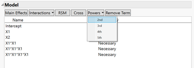

You need to add higher order terms in the Model outline for your continuous factor (X1 here):
This should give you a design that uses more values for X1.
Some explanation that might help...
The default model is a main effects model and the optimal placement of runs to estimate the main effect of a continuous factor is at the low and high extremes of the range. Placing runs at the low and high extremes is the best for estimating a simple linear main effect of a continuous factor. Custom Design is doing what it should do: giving you the optimal design for estimation of the model that you have specified. When you specify higher order terms in the model, this forces Custom Design to place runs in the middle of the range - you need points in the middle to estimate a curved line.
