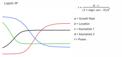

Hi, can anyone provide information on the meaning of the parameters of the Logistic 5P Richard function especially theta3? (jmp8)

Hi @RO1,
You can find an explanation about the terms of the Logistic 5P function here : Statistical Details for Fit Curve Models
The letters may be different, but the equation is the same. When expanding the expression from JMP Help, theta3 would be related to the term a.b in the equation, so it would be related to growth rate and location.
You can also find explanations about the terms in this equation here : Brendan Bioanalytics : 5PL Curve Fitting
Help Online - Origin Help - Logistic5
Hope this answer may help you,
Victor GUILLER

Thank you Jim. I had not seen exactly this guide to nonlinear modeling references, and it is helpful.  However, there is no reference for the Logistic 5P (Richard Function).  I have found several models in the literature, but none are exactly like what is given in JMP.  If someone has a reference for this model, theta1 + [(theta2-theta1)/(1+Exp(theta3+theta4*X))^theta5)], it would be appreciated.  The one that is troubling me is theta3.

Hi @RO1,
Victor GUILLER

One thing though - I assumed that theta4 was related to growth rate.
