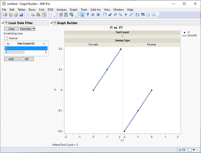

Maybe using Local Data Filter would be enough? Change Test Count modeling type to Ordinal or Nominal and then you can get something like this:
Script created by JMP:
Graph Builder(
Size(536, 491),
Show Control Panel(0),
Variables(X(:V1), Y(:I1), Group X(:Test Count), Group X(:Sweep Type)),
Elements(Points(X, Y, Legend(46)), Smoother(X, Y, Legend(47))),
Local Data Filter(
Add Filter(
columns(:Test Count),
Where(:Test Count == 1),
Display(:Test Count, N Items(2), "List Display")
Graph Builder(
Size(536, 491),
Local Data Filter(
Add Filter(
I'm not sure what you mean by splitting the axis. You could possibly create new column with additional grouping and use that as other local data filter or for example as Page
