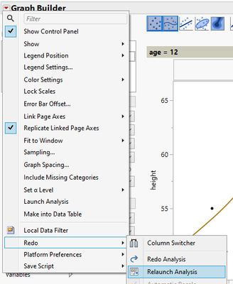

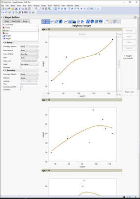

I have JMP 18.2 and just got started using it.  I would like the legend to show up on each page with each graph rather than just the first one.  Is there a quick, easy way to do this?  I am just a beginner so looking for something basic and uncomplicated:)

One option is to use By instead of Page
Page
Go to red triangle and relaunch analysis
Move Page column to By
Enable auto broadcast / hold ctrl and press done
Now you have multiple graph builders
Show Legend on each graph on builder when using Page
-Jarmo
