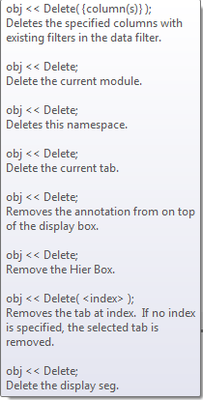

I'm not sure what's confusing about a function doing two different things based on the expressions supplied and the object it influences.  Check out the delete command below:
