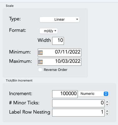

double click the x axis
maybe try editing the axis format when using the date column.
the min and max of the axis can be set here too
