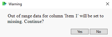

Hello,
I am on JMP 16.1
I have a set of data with a range check attached to it with data that is outside of the range that we will always exclude.
Correcting the LIMS entry is not an option unfortunately.
If possible, how would one script it to always select Yes on the resulting prompt below for the range check?
Thank you for any help, every day you learn something new about this program.

I see what you mean, and I am not sure how to suppress that warning message.  For this use case though I would just skip the Range Check function and do this instead:
Names Default To Here( 1 );
For each row( dt,
	if(:Height < 53, :Height = Empty());
	if(:Height > 65, :Height = Empty());

Hello Byron,
Thanks for looking into it.
The Big Class source does not have any data outside of those ranges and wouldn't prompt the box. I tried following that prior to this and couldn't get it to work.
There are only 40 data points in that set and if you tighten the range check to exclude points then the prompt appears in the log of the Scripting Index.
Am I understanding it correctly?

At least for me the message is written to the log but the script does continue.  I am sure there is a more elegant solution to clean up your log, but the middle four lines here is a 'brute force' approach:
log entry = Log Capture(:Height << Range Check( LE LE( 48, 62) ));
if(
	is missing(regex(log entry, "^(\!NOut of range.*Continue\!\?\!N$)|()")),
	throw("Unexpected problem in range check:\!N" || char( log entry ) )
check = :Height << Get Range Check;
Show( check );
To simulate an error (I don't know what might cause Range Check() to fail) you can replace the log entry line with this:
log entry = Log Capture( 1/"a" ) ;

Hello ih,
I am guessing part of the problem I am having is that I am trying to script it into a JSL Quote into a clickable button to pull the data from the LIMS. If I run your script outright then it works exactly as you described. But if I put it into a button then it stops working.
Specifically it gives the throw response of "Unexpected problem in range check:" but there is no information after the colon to tell me what it is getting stuck trying to do in the range check. If I substitute the log entry line like you said then it does give me something to work with "Cannot convert argument to a number [or matrix] in access or evaluation of 'Divide' , 1 / /*###*/"a" /*###*/" When in the button it is also giving the same dialog box as I had described in the original post.
It sounds as though this just might be more of an effort than it is worth to try and script away.
JSL is the first language I am learning so there is still so so much to learn about it. Something tells me this is something small and fundamental that I do not understand yet.
For each row( dt,

Thanks ih!
I've tried it and that does exactly what I am looking for.
Thank you for your help, this has quite a few applications so far and I am wondering where else I can apply this logic.
