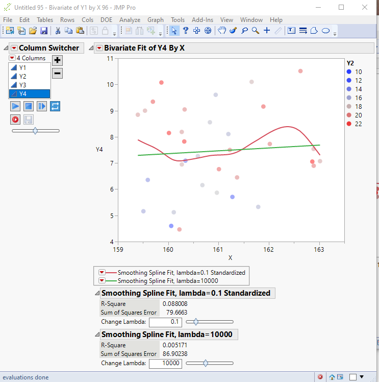

The best way to handle what you are wanting, is to use a Column Switcher
names default to here(1);
dt = Current Data Table();
Bivariate(
	Y( :Y4 ),
	X( :X ),
	Fit Spline( 0.1, Standardized, {Line Color( {212, 73, 88} )} ),
	Fit Spline( 10000, {Line Color( {61, 174, 70} )} ),
	Column Switcher( :Y4, {:Y1, :Y2, :Y3, :Y4} ),
	SendToReport(
		Dispatch(
			"Bivar Plot",
			FrameBox,
			{Frame Size( 444, 359 ), Marker Size( 6 ),
			Marker Drawing Mode( "Normal" ), Transparency( 0.5 ),
			Row Legend(
				Y2,
				Color( 1 ),
				Color Theme( "Blue to Gray to Red" ),
				Marker( 0 ),
				Marker Theme( "" ),
				Continuous Scale( 1 ),
				Reverse Scale( 0 ),
				Excluded Rows( 0 )
It allows one to interactively make changes to the graph, and then when a new column is selected all of the changes are applied to the new column.
If you still want to do this not using the Column Switcher, what you need to do, is in your Radio Box, when a new selection is made, you extract the Script for the Bivariate, and then parse the script, replacing the the old column name, with the new column name, delete the old Bivariate report, and then run the newly modified script.

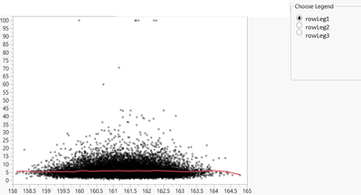

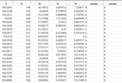

this works, is there a way to create row Legend selector so I can switch between legends,
lets say I have 2 more rows like this:
then in the graph in addition the the column selector I will have on the right side a legend selector
I tried using a script from another post, but each time I switch the row legend, it gets duplicated like this:
I tried going over the tree structure and deleting but it doesn't work..

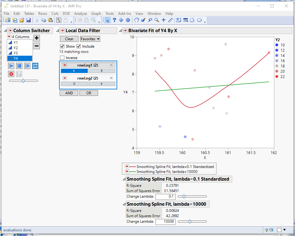

I believe that you can get what you want by using a Local Data Filter and setting it up into one of it's several options
Bivariate(
	Y( :Y4 ),
	X( :X ),
	Local Data Filter(
		Auto clear( 1 ),
		Add Filter( columns( :rowLeg1, :rowLeg2 ), Where( :rowLeg1 == "A" ) )
	SendToReport(
		Dispatch(
			"Bivar Plot",
			FrameBox,
			Row Legend(
				Y2,
				Color( 1 ),
				Marker( 0 ),
				Marker Theme( "" ),
				Reverse Scale( 0 ),
				Excluded Rows( 0 )
Take a look at the documentation on the Local Data Filter, to see how to change it to make it handle your specific need
Jim

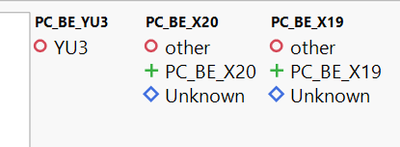

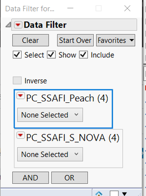

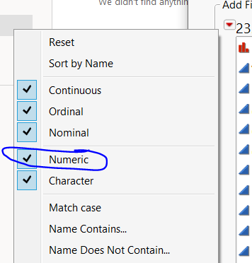

this works great, looked at the documentation but didn't find how to do something. not sure its possible
In the data filter option you can unselect numeric (picture below), how can I do this in JSL?
I tried following this post
https://community.jmp.com/t5/Discussions/Data-Filter-only-by-columns-that-are-of-type-character/td-p...
But I get this:
but what I actually want is just a list filtered with only characters or if I can filter by words that include only words that start with "PC_" for example
txnelson
Re: JSL replaceing a frame box based on check box
I do not see a way to remove the numeric columns via JSL.

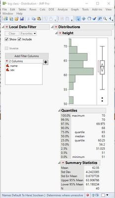

Taking a second look, I have come up with a way to only display the Character columns.c1.JPG
Names Default To Here( 1 );
dt = Open( "$sample_data/big class.jmp" );
dis = Distribution( Continuous Distribution( Column( :height ) ), Local Data Filter );
mylist = (Report( dis ) << top parent)["Local Data Filter"][ListBoxBox( 1 )] << get items;
For( i = N Items( myList ), i >= 1, i--,
	If( Column( dt, myList[i] ) << get data type != "Character",
		(Report( dis ) << top parent)["Local Data Filter"][ListBoxBox( 1 )] << remove item( i )
Jim
