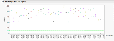

Hi all,
I have made variability charts in the past but for some reason I am getting this greyed background for the graphs that makes it seem like it is unselected as below:

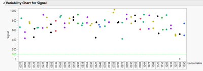

When I click on the graph as below the color is how I expect it to. Is there some jsl code that accomplishes this? I have tried to "Select" the object but it highlights the entire region and doesn't provide me with the below picture.
Any help would be appreciated. Thanks!

Can you share the JSL script of this visualization? I think it's just selection issue.
You can click the red triangle > select save script to script window to get the JSL code of this visualization

Hi, unfortunately the script is private per my company policy but the red arrow save script generates the same code as I have in the script. Likewise when clicking the graph, none of the actual script changes. Sorry I can't provide more than the pseudodata above.

This is the most generic I can make the code. I am essentially adding 5 more variability charts sig2-6 to the v list box named vlis by appending. And they are all greyed out until I click in the middle of each graph. Hope this helps.

I think you did some Selection & Excluded Rows before generate the graph.
May be you could add below line before create the graph
dt << Clear Row Selection();
Check below community discussion as well if it is relevant.
