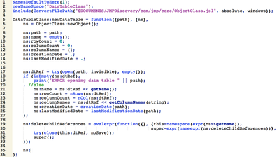

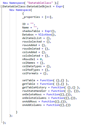

Almost universally I see that the code authors do not take advantage of JMP's strange decision to ignore white-spaces and case in names.  Below are some examples.
It seems that most people use built-in functions -- such as Insert Into() -- with white-spacing, but for user-defined names generally opt out of doing it.
My main question is why?  I find that code is much quicker to read when using white-spaces as one would in general writing.
I can understand when someone comes from a traditional programming language, but I've seen quite a few folks here at my job that are first-time scripters, and they will generally do the same (use spaces for built-in names, not use spacing for user-defined names).
Personally I've grown to greatly appreciate the flexibility that JSL affords names, but I'm curious as to what other folks here think.
Examples:
from @drewfoglia  in this post:
from @Phil_Brown  in this post:
The file libRecall_v2_0.jsl by @MikeD_Anderson
