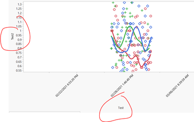

for example in the first graph that is marked in the picture above I want to get test and test2
this graphs are already open in JMP and I don't have control over them (in terms of editing the script that creates them)

I now want to get the X Y values (what's marked in red) but I'm not sure how to access that value
all I'm able to do is get the title (what's marked in yellow).
I found that with "get XML" instead of "get Text" does give me also the names, but there is ALOT of data there and I hope there is an easier way
