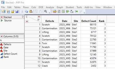

Here is a little script that produces the below output
Names Default To Here( 1 );
dt = Current Data Table();
dtStack = dt << Stack(
	columns( :Site1, :Site2 ),
	Source Label Column( "Site" ),
	Stacked Data Column( "Defect Count" ),
	Output Table( "Stacked" )
dtStack << Sort(
	By( :Date, :Site, :Defect Count ),
	Order( Ascending, Ascending, Descending ),
	Replace Table( 1 )
// New column: Column 5
dtStack << New Column( "Rank",
	Numeric,
	"Continuous",
	Format( "Best", 12 ),
	formula( Col Cumulative Sum( 1, :Date, :Site ) )
dtStack:Rank << delete formula;
dtStack << Select Where( :Rank > 3 );
dtStack << delete rows;
Jim
dtStack << Sort(
	Replace Table( 1 )
	Numeric,
	"Continuous",
Jim

Re: JSL : Top3 volume per week per site
Jim, it works beautifully! Thanks!
