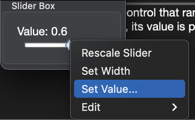

If you run this example, you can right-click the slider to set a specific value:
Let's suppose I set this to 0.8. If I do, the slider moves, but the script associated with the slider fails to execute. That is, the text box above the slider doesn't update.
Question 1: Why?
Question 2: Is there a different way to transfer the new value to the Text Box? I tried to convert the code to use the Set Function message but this didn't solve it.
I have observed that if you right click a slider in a Platform (such as Custom Profiler) and Set Value that the platform seems to respond correctly (slider and associated Text Edit Box both move as expected), so I can tell there is some way to do this in JSL. I just don't know what that is.
I'm running 15.2.1 Pro on a Mac.

Thanks for providing a clear example and question. It made it easy to verify that this is a bug in JMP 15 (perhaps earlier versions). The callback for the slider isn't being triggered on the Set Value.
I also verified that we have fixed it in the upcoming JMP 16 release.
There may be a tricky workaround you could code in JSL, but where you see it working in the built-in platforms it's not being done through JSL.
