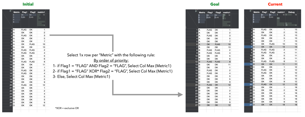

Hello All,
I would like to write a JSL script to select the rows in a table with “complex” conditions:
I need to select ONE ROW per Metric (Column :Metric) with conditions IN ORDER OF PRIORITY:
1- if the condition Flag1 = “FLAG” AND Flag2 = “FLAG” exists, Select Col Max (:Metric1) of this condition
2- if the condition Flag1 = “FLAG” XOR Flag2 = “FLAG” exists, Select Col Max (:Metric1) of this condition
3- Else, Select row Max (Metric1)
Below a tentative code using For Each Row () and a debug column, but my attempt doesn’t work and is not very elegant.
Also, I am not sure how to do an XOR (exclusive OR) in JLS without using combination of basic gates.
Is there a better way to do this?
Note: please find attached a PNG that illustrate my request
Thanks
-Voiz

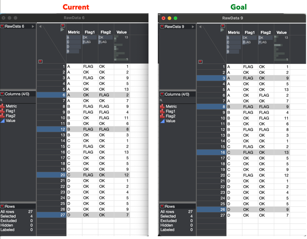

Re: [JSL] Select rows using "Complex" conditions
Hi Jim,
Thanks for your reply,
I am very sorry, I realize that my request wasn’t very clear.
After prioritizing the group of rows within each Metric (which works well with your script),
I need to select the row of the highest value (Column :metric1), Not based on Max( theRows ) like in the current script.
The dummy table I provided before added to the confusion because "Col Max (:metric1)" within each group is always equal to "Max (theRows)".
Your suggested script doesn't work anymore with a new set of values. Below I replaced :metric1 with :Value to remove the Column name  ambiguity, plus I re-shuffled the numerical values.
I tried to play around with "Col Max ()" added as a rule inside the "get rows where()", but wasn’t successful.
(I realize my English is not perfect, so I added an image to describe my goal, if my wording isn't precise enough)
Do you have a suggestion?
Thanks again
Voiz
