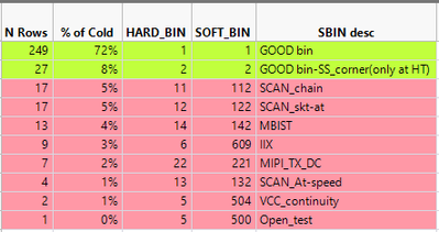

I have written the script in JSL, and the last point is to color row by SOFT_BIN
IF SOFT_BIN = 1 OR 2 >> Color all rows in Green
OTHER rows >> Color in Red
And the second question is,
It's not exactly Red or Green color
I have attached the print screen where I chose the colors,
but how I can know the index of this color and use the shade of color it in the script?

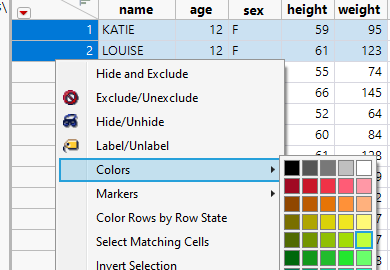

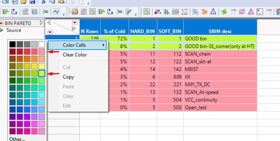

There are quite a few different options, but one quick one is to color the rows by selecting some of the rows and right clicking on row number
Then select the color you are interested in. If you have JMP16+ and Enhanced Log enabled you can find the color there
// Set selected rows' colors
Data Table("Big Class") << Clear Select << Select Rows([1, 2]) <<
Colors("Light YellowGreen");

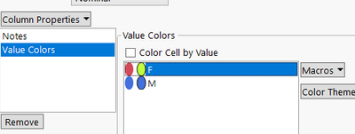

You could also set the same color as Value Colors column property and get it from enhanced log OR by copying column properties
Add Column Properties(
	Set Property("Notes", "Explore data adventurously"),
	Set Property("Value Colors", {"F" = 76, "M" = -4354269})

But I want to color all rows as I have shown in the first print screen
Can you tell me how I can do it by script?
Data Table("BIN PARETO") << Select Rows << Select where (:"SOFT_BIN" < 3) << Colors("Light YellowGreen");
Data Table("BIN PARETO") << Select Rows << Select where (:"SOFT_BIN" > 2) << Colors("Light Red");
