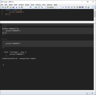

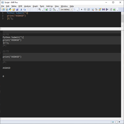

jthi
Re: JSL - Escape Character Syntax Error?
The issue could be caused by incorrect indentation of the python code.
This is from JMP18, but I would guess it is same in JMP17
-Jarmo
