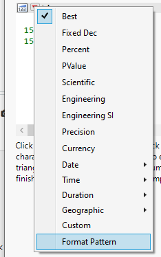

I created quick test.csv with only couple of rows and used the option to directly modify it in the import platform:
Script:
Open(
	"$DOCUMENTS/JMP/test.csv",
	columns(
		New Column("time",
			Numeric,
			"Continuous",
			Format("Format Pattern", "<YY>/<MM>/<DD>/<hh24><::><mm>", 14),
			Input Format("Format Pattern", "<YY>/<MM>/<DD>/<hh24><::><mm>")
	Import Settings(
		End Of Line(CRLF, CR, LF),
		End Of Field(Comma, CSV(0)),
		Strip Quotes(1),
		Use Apostrophe as Quotation Mark(0),
		Use Regional Settings(0),
		Scan Whole File(1),
		Treat empty columns as numeric(0),
		CompressNumericColumns(0),
		CompressCharacterColumns(0),
		CompressAllowListCheck(0),
		Labels(1),
		Column Names Start(1),
		Data Starts(2),
		Lines To Read("All"),
		Year Rule("20xx")
So maybe the "result" format must also be done with Format Pattern?
-Jarmo

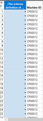

I am still a having issues where the column still is giving null results:
The column is changing to the desired format as if performing manually. Could it be because the original column name is not changing due to the name being "; The schema definition " ?
Thanks again.
~ Luke :)

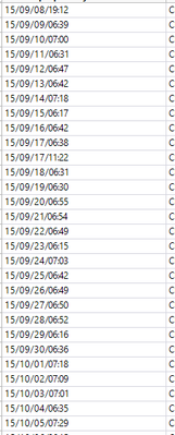

If you try importing it first as character, what does it look like? Only empty cells?
New Column( "; DateTime", Character, "Nominal),
-Jarmo
LukeFarrell
Level III
Re: JMP16 Using Custom Date Formats In Scripts
If taken as Character we get the following:
Also, in regards to my previous reply, I edited the original csv and removing the ";" does not change the issue.
~ Luke :)
