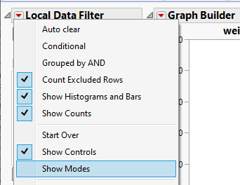

I can see how this might be difficult to figure out, particularly for Graph Builder, because it hides the Local Data Filter modes by default.  I hope the following explanation helps other users stumbling on to this page.
To share a Graph Builder report with a Local Data Filter as Interactive HTML and have the Local Data Filter be interactive:
 1. Select "Show Modes" from the Local Data Filter's red triangle menu.

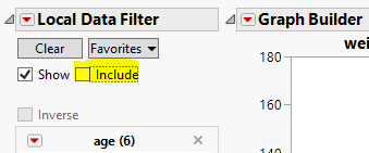

2. Uncheck the Include mode.
3. Note that the behavior of the Local Data Filter now only shows/hides data rather than excluding data. For example, if you have fit lines in your graph, they will not be recalculated when you interact with the Local Data filter.
4. Export to Interactive HTML and the Local Data Filter should be interactive in the HTML version with a show/hide behavior.
