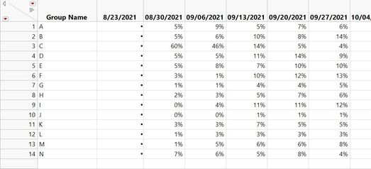

I have an Excel table that I am manually updating on a weekly basis. Next, I open this table in JMP and Stack every column from column 2 onward. With every weekly update, I add more columns to the initial table. I recently took an Intro to JMP Scripting class and I'm looking to automate this process a bit instead of re-Stacking it from scratch every time.
Here is what the table looks like in JMP before performing the Stack:

But where I had a question is how do I change the JMP script to ask it to Stack columns 2 through end?
I have the following from doing a manual Stack in JMP and looking at the source script:
