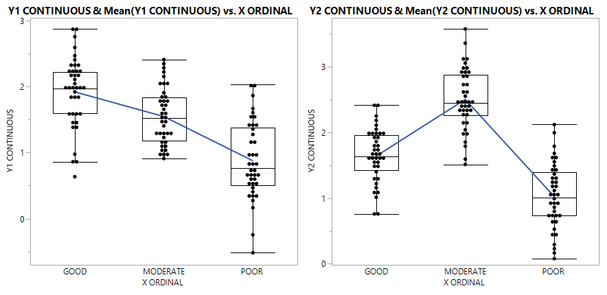

In the mock data, I simulated two behaviors:
  1. Y1 has a clear negative trend across the Ordinal X
  2. Y2 has a weak trend across Ordinal X
I have seen examples where the Ordinal X values are converted to a continuous scale to calculate a linear regression. Still, this approach does not seem appropriate because it implies a linear relationship between X values that may not exist.
