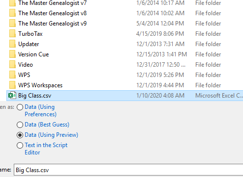

One the one computer that is doing the auto convert, I would suggest that when selecting the file for input, that you specify the "Data (Using Preview)".

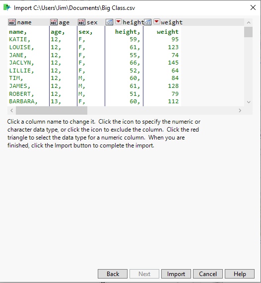

You can then specify that the Hex column not be interpreted as being numeric, but rather to keep it as a character.  In the preview window below, I have chosen to keep the Age column as character.

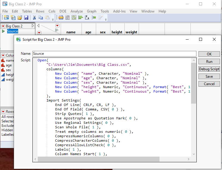

Additionally, once you have read in the .csv file once, you can go to the Source entry for the table, and Edit it and save the JSL code that used to read in the file.  You will see in the JSL how JMP sets the column to be character.
