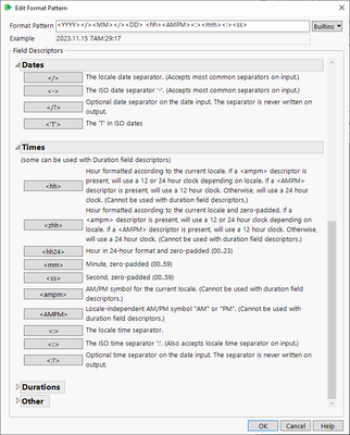

jthi
Re: JMP Time Formatting
You can use Format Pattern to modify your date and this has most likely been JMPs solution as the wish list item has been set to Delivered.
Numeric Formats (jmp.com)
How do I apply Custom Date (and Duration) Formats in JMP?
