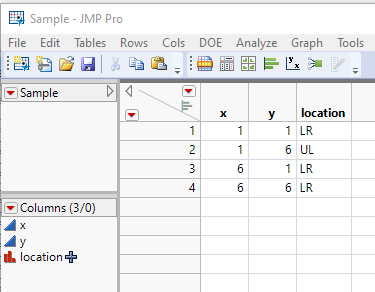

txnelson
Re: JMP Scripting Noob: How to input a new column based on filtering data from two columns?
This can easily be done by finding which row has the different combinations of min and max values in the data table.
names default to here( 1 );
dt = New Table( "Sample",
	Add Rows( 4 ),
	New Column( "x",
		Set Values( [1, 1, 6, 6] )
	New Column( "y",
		Set Values( [1, 6, 1, 6] )
dt << new column("location", character, formula(
	:location[(dt << get rows where(:x==col max(:x) & :y==col max(:y)))[1]]="UR";
	:location[(dt << get rows where(:x==col max(:x) & :y==col min(:y)))[1]]="LR";
	:location[(dt << get rows where(:x==col min(:x) & :y==col max(:y)))[1]]="UL";
	:location[(dt << get rows where(:x==col min(:x) & :y==col min(:y)))[1]]="LR";
Jim
