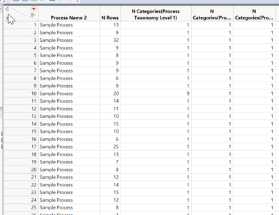

Hi - Can someone please tell me how I would go about coloring a cell that is not equal to 1 in the summary sheet below using JMP Scripting, starting with the N Categories (Process Taxonomy Level 1) column? Also, these are just sample columns, there are 40 other columns so I don't want to specify the actual column names in the script. Lastly, If a cell is colored in the summary table, can the color be applied to the original data table, to which the summary table is linked?

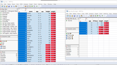

Here is one way to handle the issue:
Names Default To Here( 1 );
// Open Data Table: big class.jmp
// → Data Table( "big class" )
dt = Open( "$SAMPLE_DATA/big class.jmp" );
 dtSum = dt << Summary(
	Group( :age ),
	Mean( :height ),
	Mean( :weight ),
	Freq( "None" ),
	Weight( "None" ),
	statistics column name format( "column" )
// Get the column names of the current columns
sumColNames = dtSum << get column names(string);
// Remove the first 2 columns from the list
remove from( sumColNames, 1, 2 );
// loop across columns finding all cells > 63
For( i=1, i<= N Items( sumColNames ), i++,
	// select all rows where cells are above 63
	dtSum << select where( as column( dtSum, sumColNames[i]) > 63 );
	// Color cells in summary table
	as column(dtSum, sumColNames[i]) << Color Cells( red, dtSum << get selected rows );
	// Color cells in original table
	as column(dt, sumColNames[i]) << Color Cells( red, dt << get selected rows );
Jim

dn610
Level III
Re: JMP Scripting Coloring Cells Based on a Criteria
Thank you so much! It worked.
As a follow up question, if I wanted to create an indicator column with a 1 to mark any row with a highlighted cell in the data table, how can I do that?
txnelson
  1. Read the documents, Discovering JMP and Using JMP.  Both documents are in the JMP Documentation Library available under the Help pull down menu.
  2. To add an indicator column
    1. Create a new column in both the original data table, and in the summary data table.  Call the column "Flag" or "Indicator" etc.
    2. Add to the script, as the last 2 lines in the For() loop
      dt:Flag[dt << get selected rows]=1;
      dtSum:Flag[dtSum << get selected rows]=1;
  3. Take the time to study the script to make sure you understand it.
Jim
