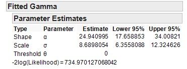

Do you know with the LEV how that correlates to the Lambda and Delta values that come from JMP distribution analysis? JSL asks for random LEV(mu, signma)
I tried running them as just the mu and sigma that JSL requests, but that does not work. I cannot find any connections online, but I do not know these statistics themselves that well.
For Gamma, a 500,000 point simulation suggests that the lambda that JSL asks for random gamma (lamda, scale)is the alpha from the estimate and the scale is the scale/sigma, but can anyone definitively confirm? I assume threshold is just a shift at the end (e.g +0 for the example below).
Why does JMP sometimes use the same letters and/or names, but others times not. Lambda vs alpha, scale and scale, scale vs sigma.
Thanks
