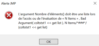

However, the second one, I get this message:
"The Number of items() argument must be a list when accessing or evaluating "N items", ..."
Here is my program:

	ncols1 = N Items( coltstst1 << get list );

Re: JMP Script: Problem with a Link Platform
I can't say for sure without seeing the data table you're working with or the full script, but my guess is that the Column Switcher message on line 4 isn't successfully creating a column switcher. For example, if the first argument isn't a reference to a column in RAW_DATA_TABLE, then the column switcher is not successfully created, which means that Get List can't return a list of columns as the argument for N Items.
Ensure that :Name( "Y" ) is returning the column reference you expect and that without_limits is a list of column references.
