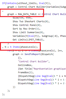

jthi
Re: JMP Script: Message with if condition
Make sure your , are in correct locations
If(Contains(without_limits, Eval(Y)),
	graph = Control Chart Builder(Variables(Subgroup(:X), Y(Eval(Y)), Phase(:"Version")))
	graph = RAW_DATA_TABLE << Control Chart Builder(
		Size(534, 450),
		Show Two Shewhart Charts(0),
		Show Control Panel(0),
		Sort by Row Order(1),
		Show Limit Summaries(0),
		Variables(Y(Eval(Y)), Subgroup(:X), Phase(:"Version")),
		Get Limits(LIMIT_TABLE),
, N = N Items(phaseLevels);
	For(i = 1, i <= N Items(phaseLevels), i++,
		graph << SendToReport(Dispatch(
			"Control Chart Builder",
			OutlineBox,
			{Set Title("Représentation graphique")},
			FrameBox(2),
			{DispatchSeg(Line Seg(Eval(3 * i + N - 2)), {Line Color("Medium Light Green"), Line Style("Dotted"), Line Width(1.5)}),
			DispatchSeg(Line Seg(Eval(3 * i + 1 + N - 2)), {Line Color("Medium Light Orange"), Line Style("Dotted"), Line Width(2.5)}),
			DispatchSeg(Line Seg(Eval(3 * i + 2 + N - 2)), {Line Color("Medium Light Red"), Line Style("Dotted"), Line Width(2.5)})}
-Jarmo
Sebastienlg
Level IV
I had a look and all the "," seem ok.
Couldn't it come from hte , in red below?
Get Limits(LIMIT_TABLE), ) , N = N Items(phaseLevels);
jthi
It could be due to both of these
Should the N Items be already outside if statement?
-Jarmo
Sebastienlg
Level IV
Right!
I wasn't looking at this ")"
Now it works well!
thank you
