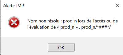

JMP SCRIPT: Name not resolve : prod_n when accessing or evaluating of "prod_n"
Hello everyone,
I got this message error:

The program works well, however I always get this message.
Do you have any suggestion to help me?

The reason for this error is that at the time of the execution of the specific line of code, prod_n does not exist in memory.  You may want to add before the If() clause
If( isEmpty( prod_n ), prod_n = .);

Great it works! Thank you very much!
