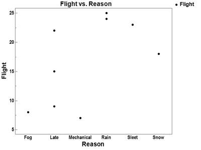

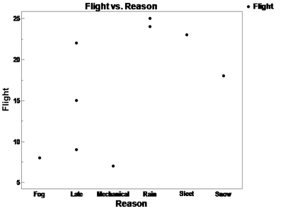

Hello, when I paste graphs from JMP into MS Onenote the resolution looks great. When I paste graphs into MS Word or Outlook the quality looks terrible. When I paste from JMP to MS Onenote then to Work, everything is fine. Any idea what setting is causing this?
JMP direct paste here
JMP Paste to OneNote then to here

Maybe they are using different options when you paste the image? Check out some of these
Getting high-quality graphics out of JMP or Saving High Quality Graphics from JMP for Publication and Presentation or Saving Publication Quality Graphics with JMP | JMP (all give similar ideas)
