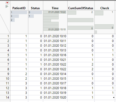

In the first one sort the data first by patientid and time, then create two formula columns and check should have the information you are interested in. There might be some edge cases this will miss (like the last row).

dt << Sort(By(:PatientID, :Time), Replace Table, Order(Ascending, Ascending));
//add formula columns
dt << New Column("CumSumOfStatus",
	Numeric,
	"Continuous",
	Format("Best", 12),
	Formula(Col Cumulative Sum(:Status, :PatientID))
dt << New Column("Check",
	Numeric,
	"Continuous",
	Format("Best", 12),
	Formula(
		If(Row() == 1, :Status);
		If(Lag(:CumSumOfStatus, -1) == 1 & Lag(:PatientID) == :PatientID,
			1,
			0
Second one is expecting that patientid has only one 0 status before first 1 status which allows you to just get minimum times for both statuses using summary:

dt << Summary(Group(:PatientID), Min(:Time), Subgroup(:Status), Freq("None"), Weight("None"));
