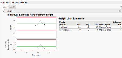

For JMP 18 the "By" factor was changed so that you could have the broken out factor levels be controlled by an overall control box as well as arrange the panels.  So a lot more versatility but it did break how you were using  CCB.  On the bright side, you can do cool stuff like this now:
or this
Hope this helps!
Steve

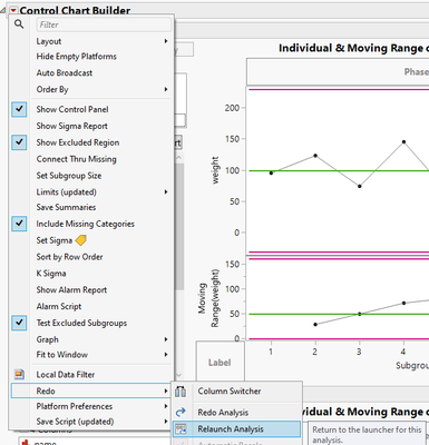

Yeah column switcher is amazing!  As for arranging in rows, on any platform where you use the "By" option you will get a new grouping of menu options that allows you to do a bunch of cool new things.  Here is how to arrange in rows.
Steve

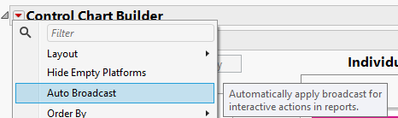

It seems like you cannot really utilize the auto broadcast either in Control Chart Builder. Could be like it is supposed to be, oversight or a bug.
You could try with Relaunch Analysis from the highest level red triangle
There is also shortcut Recall Last Platform (can be found from View menu), Ctrl + L, which will relauch the same platform which might work in some cases.
-Jarmo

Jarmo - Thanks for the alternative ideas.  The Redo/Relaunch would have worked also.  I will try to remember that short-cut!  Steve's solution interestingly was on the same Re-do menu.
