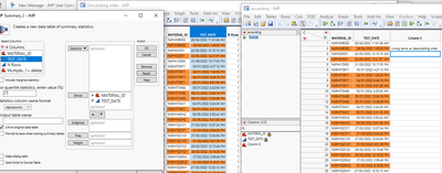

Hi want to report a big in JMP16.2 when you do a Table Summary eg by ID and date it is not sorting data per selection
Note have TEST_DATE col set as format d/m/y h:m:s.
I also noticed it works fine if you use table-->sort but using table-->summary and sort arrows it isnt working.

I can confirm that this was a bug in JMP 16 and has been fixed in JMP 17. I'm sorry you've run into it.
JMP 17 is a complimentary upgrade for most licenses. Check with your JMP software administrator to get it. All administrators were sent instructions on how to get JMP 17.
