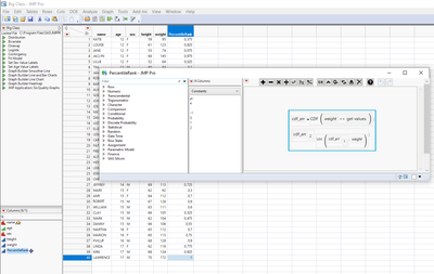

You can do this by a formula or JSL snippet as you like, see screenshot and script below.
The first part of the formula generates the table for values and percentiles, the second looks up the percentile for the current row.

WoHNY
Level IV
Re: JMP 16.2 Equivalent to Excel PERCENTILERANK Function?
Georg:
Thank you for your input. I adjusted the JSL to match my table and column name but I am guessing this is a very processor intensive calculation. It has been over 20 minutes and the wheels are still turning. I have about 240K rows of data to deal with. It looks like I'll stick with the Excel method I set up until I can find time to investigate this issue in more depth. Thanks again.
