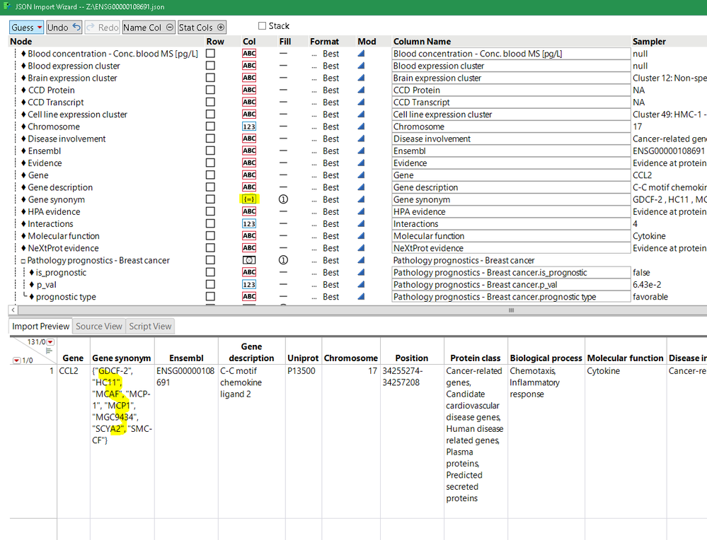

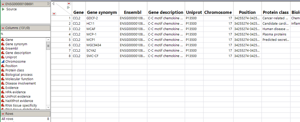

See if the json import wizard does what you need. There are several ways to attack it; a JSL solution might look like
dt = open("z:/ENSG00000108691.json",guess("huge", stack(1)),jsonwizard(0));
change the 0 to a 1 to see the wizard dialog.
this file seems to have 8 records with the best guess choice. If that doesn't match your expectation, you might want to hand select what you want via the GUI, but I'm not sure you can do much more than remove unneeded columns.
(file->open, select the .json extension, select the data using preview, open.)
json (and XML) dialogs are almost identical.json (and XML) dialogs are almost identical.
