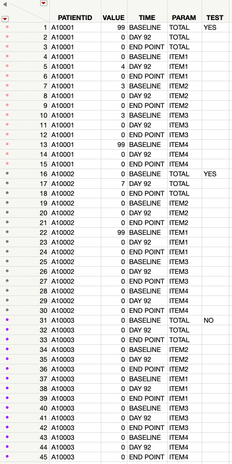

Here is an example of what the data table looks like (real patient information redacted for privacy)
Screen Shot 2019-10-15 at 7.17.55 PM.pngScreen Shot 2019-10-15 at 7.17.55 PM.png

Complex rules in a stacked table can be done, but they get messy. It is much easier to manage if the table is unstacked by PATIENTID and TIME, where the rules are applied by PARAM. If the table is extremely large this method might not be efficient.
Attached is your example table with a two additional PATIENTID to test thes 3 rules.  Before using the attached script, you should check if the formula adequately captures your 3 rules. I added a comment column and colors to make it easier to check.
Once split, here is the formula for the three rule TEST column. The script also includes the JSL code to unstack and reorganize the table.
