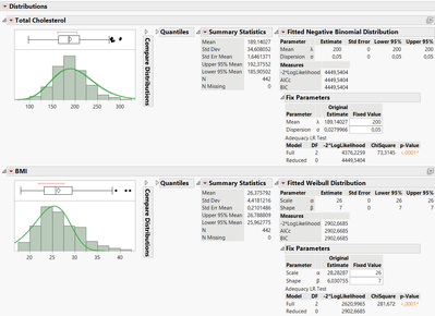

Did you check the Fit Distributions option in the Distributions platform ?
Clicking on the red triangle next to the variables you have selected previously in the launch dialog of this platform, you have the option to fit continuous and/or discrete distributions (and also to fit all and use the most relevant one).
When clicking on the red triangle next to the distributions you have fitted, you have the option to "Fix Parameters" to test the values you mentioned (example here with different values that the ones you proposed) :
