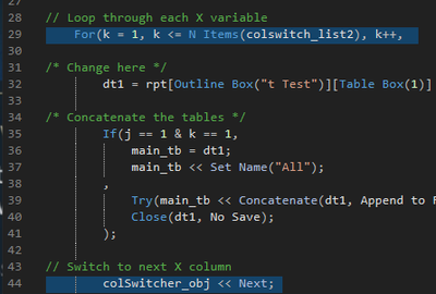

jthi
Re: Is there a way to create a report for 2 column switcher simultaneously ?
You are using wrong column switcher object references inside your loops (inner loop which has N Items(colswitch_list2) should change colSwitcher_obj2 << Next).
Also use
when posting JSL to JMP Community as it makes reading the post much easier.
-Jarmo
