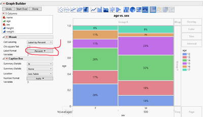

>>decimals in cell labels:
This can be done in the Graph Builder version of a mosiac plot.

- Using Graph Builder (rather than fit X by Y) does let us set the numeric format, so that is a solution to my first point.
