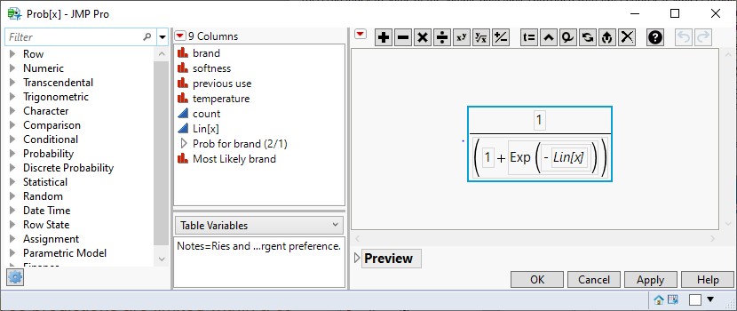

This suggestion is commonly performed in logistic regression, which is modeling the proportion (probability) of an outcome. The logit function converts the [0,1] variable to [-inf,+inf]. Here is the back transform:
The Lin[x] in this formula would be replace by your prediction formula column.
